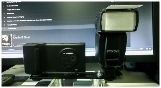

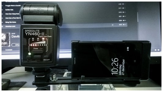

A few months ago i bought this external flash for my lumia 1020, because you can sync it with the xenon flash of the lumia 1020.
But i had a problem, it didn't sync properly, only 1 out of 10 was fine. I almost gave up, and then i had an idea. I made all the pictures with Nokia Camera, and it didn't work out. So i tried the standard app "Camera", and it works flawless, time and time again. Just put the mode button on S2, and it synchronises perfectly. The flash is very good and very cheap, around 60 dollars. It comes with a baseplate so you can put the flash anywhere you want, it will always flash, no cabels, no nothing.
