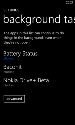

Also, please see the screenshots of the apps that I have working in the background:

I've completely removed skype and nokia drive. Will see if that helps in any way tomorrow. I haven't allowed it to die fully yet, as had only for 48 hours.

REMOVE skype and soft reset phone. make sure your microsoft account isn't stuck in constant sync because of skype.
turn off everything that you don't use including but not limited to: Wifi, Bluetooth, NFC, etc
make sure to keep pressing the back key until your home screen is the only thing that's left. (basically a terrible way to force close all programs but it's the only way until the next update)

remove battery status
run it to it completely turns off ... then let it charge for 12 hours ... don't touch it just let it charge ... at least that fixed mine... hope that helps
some people said when it shuts off turn it back on and run it again until it dies (It took me 3 times to get it to turn back on after it shut off , but I was to tired so I didn't keep running it again until it shut off, I just let it charge for a good 12 hours)
