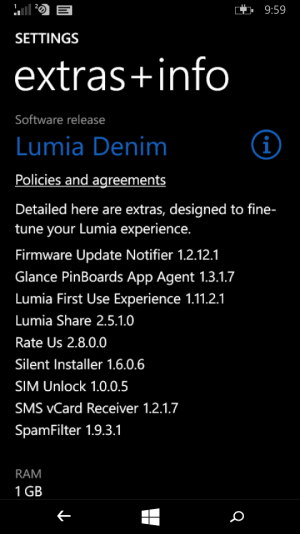

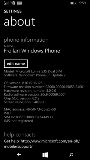

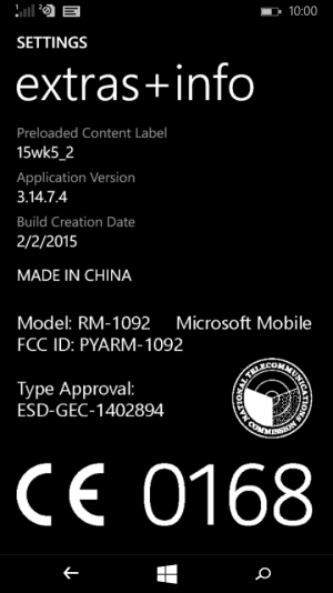

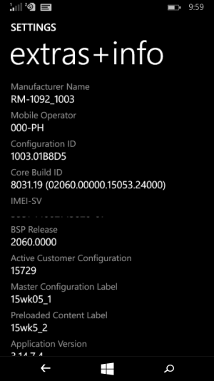

For your reference..
wp_ss_20150419_0001.pngwp_ss_20150419_0002.pngwp_ss_20150419_0003.pngwp_ss_20150419_0004.png

Your firmware version is still "15053" (02060.00000.15053.24001). The latest firmware version available according to this page is 02063.00000.15114.43004 - this is the same version installed in my L535. Make sure to check for updates since some users are reporting improvements with touch screen reliability for the Dual SIM variant after the 15114 update.
