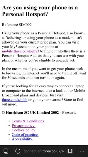

I have an issue with mine though, and I'm a bit stuck on where to go next. I cannot get any data throughput unless I'm connected to WiFi. If I try and use the internet, it comes up with page from Three UK saying that my plan does not include tethering/personal-hotspot. The problem is, I don't use tethering, and in any case, my plan DOES include tethering (checked with Three UK this evening and had this confirmed) and I also have plenty of data left this month.

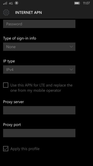

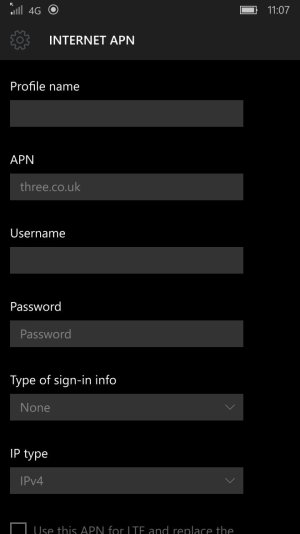

Settings - Extra - Access Point
Make a new setting for it, you can easily find the information online (look up Three UK access point) and fill out the required fields. Once done, activate it and you should be all set.
I assume the relevant section under W10M is "SIM Settings" under the "Mobile and SIM" section... Looking on Threes page, it specifies lots of setting for MMS but for the APN, it just says three.co.uk but doesn't specify any of the other settings.
See screenshots below for the current three settings (that don't work). I can see how to create an alternate setting but am concerned that I don't have enough information to make it work.
You have that section and the section I mentioned. Either way, just make sure the information is correct.
Both your way and my way ultimately end up at the same screen, so that bit is fine, however the only info to go on the page appears to be three.co.uk under the APN heading. Three's page does not specify any other things such as username or password, so i assume that three.co.uk is the only relevant bit of info. Configuring an alternate APN with the same settings does not work. Phone shows it's connected to 4G in the status bar at the top, but still no actual throughput of data... And it still comes up with a Three web page when trying to browse the web - see screenshot below.
