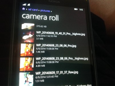

I installed the Files app and that left no doubt about this. It is saving correctly. ImageUploadedByWPCentral Forums1402352078.343397.jpg
