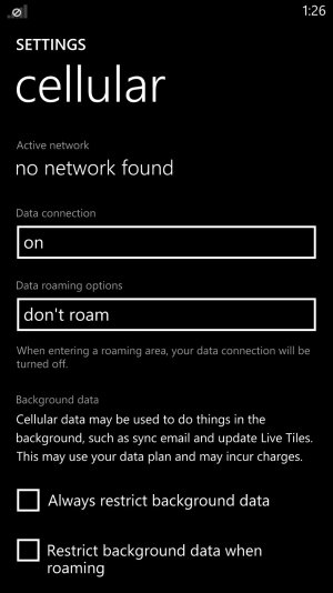

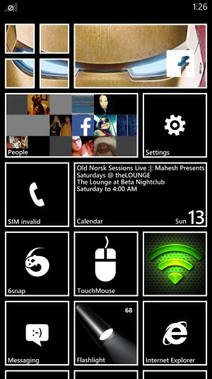

i have a at&t 1520. i went today and purchased a straight talk byop sim kit. inserted the nano and went through the steps. i got invalid sim. i went to the micro sim and cut it down. the 1520 reads no service now. not sure if its reading the sim. or what i really need to do. cant get any help from straight talk. i cant call anyone, dont have a phone. any and all help wold be greatly appreciated. i am new to windows phones but not electronics. pretty tech savy, but not really sure what to do next?

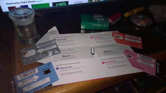

i purchased a byop kit that has both t-mobile and att sim cards. it has 4 credit card sized cards. 2 for t mobile 2 for att. one holds the nano and the other holds the standard and micro. i inserted the att nano and reads "sim invalid". i read in other post where it could be a bad sim but can not get any one from straight talk to help me. there online support is some $h!t... they have done nothing but upset me more
Make sure you have Network set to automatic and either put the sim into the phone when it is switched off or after you insert the sim then restart the phone.
You may also have damaged the sim when you were cutting it.
ok. i just did a complete reset of the phone and inserted the nano straight talk sim in and going to see what happens
i did a reset it says invalid sim. i paid almost 60 for the whole byop kit and dont want to be out. could it be i just have a bad sim card?
well. I totally learned the best lesson of all... i am a huge dumb ***!!!
so i live in a area with not the greatest signal... i went out side... turned phone on, then off... wait for it... wait for it... it works!
