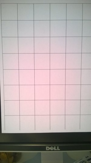

Hi all,
I have the following problem with my new Nokia Lumia 930, it seems that at the above part of the camera, the phone distorts the pictures. I noticed when I tried to take a pictures to people, the heads was so long if they was near the display's corners. So I have printed a grid of squares and then I have taken a picture from the front.. here the results...
As you can see, the squares are correct from the middle to the bottom but they became rectangles from ca. 80% of the image to the top...
The pictures has been taken from the front, without any perspective and without any lens effects!

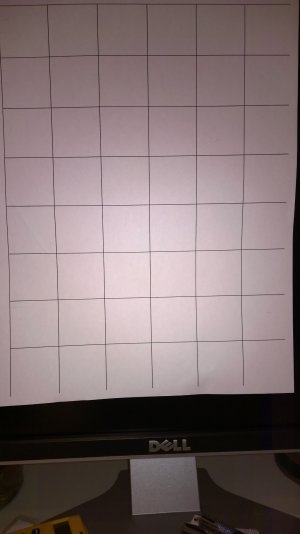

Here same photo but made with my old Nokia Lumia 920:
Unfortunately I know that I'm not the only one with this problem.. but I don't know the cause! :unhappy:
I think it's some defect to the lens. I would personally bring it to a Nokia store to have it checked. Could you post more samples of this?
I've got the exact same problem. When I got my Lumia 930, I took photos of some people and wondered why their heads look so weird on the pictures. The heads were also placed in the upper part of the picture.

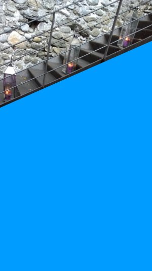

Here an other example, always made from front.. please check the last lamp on the right, it seems bigger than the other even if the three lamps have the same size!
It may not be the answer to your concern but you should also know that in photography shooting with wide angle rectilinear lens will always stretch things at the edges of the frame and it's best to not put people there unless you want some artistic effect :)
https://en.wikipedia.org/wiki/Rectilinear_lens
26mm is kind of normal wide lens.
Hi, thank you for your reply. As you can see the distortion begins from the middle of the image, with this camera is near to be impossible to take pictures to people (and to everything..). I agree with you about corner's distortion but is not possible that my old 920 is better than the 930.. :cry:

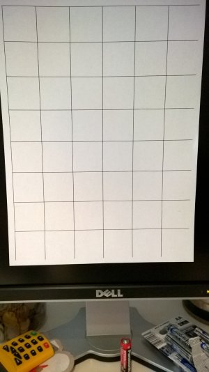

Hi all, my 930 is back from Nokia customer center! It seems that has been fixed..but! Now it works, squares are squares and lines are pretty straight.. what is strange is that when I take the picture the live picture is still warped but when it saves the picture and then I open it, the picture is correct!
So it seems that the problem was from hardware (they said to me that they have fixed something) but I think that there was some software issue too.
Honestly I was expecting more from the camera of my 930...WP_20140813_21_14_03_Pro.jpg
