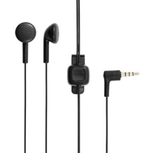

Lumia 530 and 630 came without headphones, so I tried my old WH-102 (of my asha)
But those don't work on my lumia 630 or 530, I have no ther headphones to try, so... what di you think, is that normal? Headphones work perfectly on asha 201

This do not happen with lumia 630 or 530, if you only connect them halfway (not 'till the end) they work, but work bad, sound is terrible (yes, more than the "normal" terrible sound of WH-102), but that's because they are obviously not well connected, now when you push then all the way down (slow or fast) the phone use the external speaker, do not detect headsets

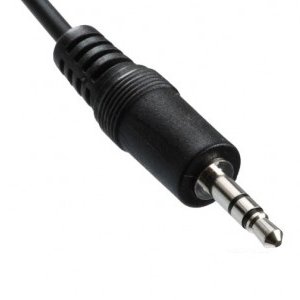

I try with some big sony headphones (over the ear, with diadem, which I hate) and they worked well, strangely, the connector of those have only two lines, like this:
And the WH-102 have three, like this:

Just matching the number of pins wouldnt do the job.
if you are keen on researching and getting the right one with the mic then read this
http://forums.windowscentral.com/wi...87-note-headset-standards-omtp-ahj-apple.html
​otherwise go for a normal 3.5mm (no mic) earphone.

As theawkr92 has already pointed, there are two main standards and that Apple crap for TRRS plugs (Tip/Ring/Ring/Sleeve) (3 black lines).
OMTP is way better than AHJ because, for some reason, they are compatible with TRS plugs (Tip/Ring/Sleeve) (2 black lines). So they work on any PC.

There are now two different standards. Nokia new ear sets become now like apple, if you tried Apple ear set on your lumia it will work.
you can make this one work if you have some technical experience or let some do it for you.
you just need to switch the mic and the ground wires , this is the only difference between the two standards.
Open the mic Box, and by soldering iron remove the mic and ground wires from the board and switch them.
In this ear set particularly you will need to remove the the ground of the speakers from the board and make short wire connected from the ground of the mic to the ground of speakers.
Try this only if you have some technical experience in soldering.
I Know it is too much for an ear set but I have some spare time so I did it !
