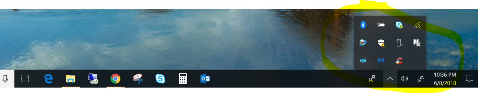

Hi,

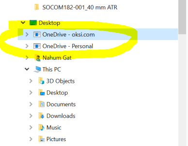

The Personal AND the business OneDrive Icons both disappeared from the Hidden Icons group. Also my One Drive Folders no longer synchronize. The folders do no even have the OneDrive icon.

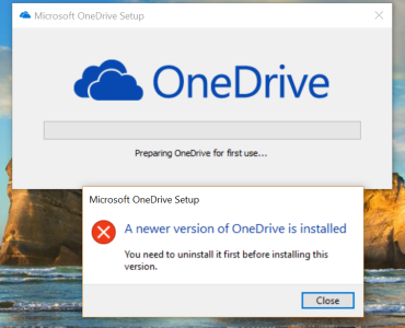

When I run the onedrivesetup I get a message that a newer version is already installed.
The files in the OneDrive folders lost their "Status" icons.

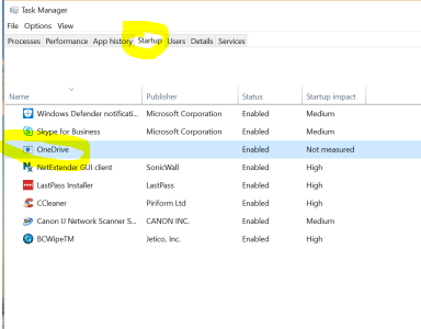

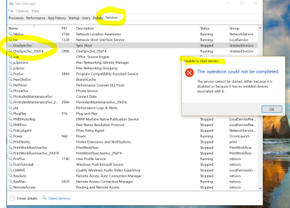

I also included below a couple of screenshots from the TASK MANAGER.
