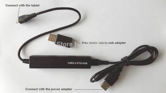

josecmh
Mar 17, 2015
1
Visit site
I have received today this cable:
And it works!!! (in the number 2 position)
I can't write links, but I bought this cable in Aliexpress.
