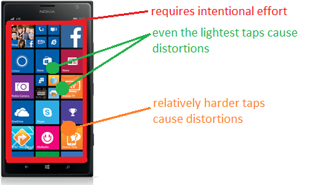

Does anyone have LCD distortions when applying light pressure on their phones? I feel this is a symptom exclusive to only the cheapest phones, and should not be exhibited by such a beautiful device...
Takes little effort to cause screen distortions, which gives some serious implications about the life of the display. Anyone notice this?

I can put 3lbs force on my L925 and there will be no distortion, whereas not even 0.2lbs causes distortions on the L1520. Had me scared lol

The distortion occurs on the screen where the camera bump is. It seems to be related to that part of the frame exerting force on the backside of the LCD panel.
