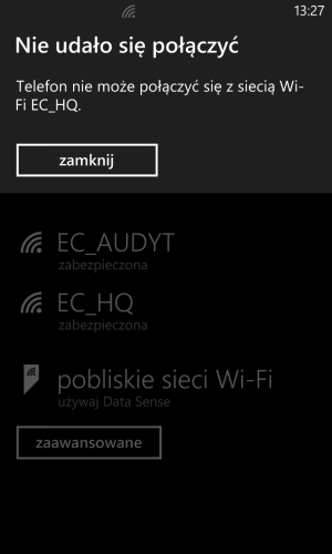

EDIT:
Screenshot of the message when trying to reconnect:
In English it says:
Couldn't connect to network
Phone can't connect to selected Wi-Fi network
