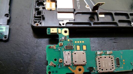

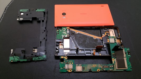

Ok so im sick of waiting till MSFT gonna give an answer so today ?'m gonna void my warranty and replace the microphone myself.
Ill keep you guys posted.
20150929_085841 (Large).jpg20150929_085845 (Large).jpg20150929_085858 (Large).jpg

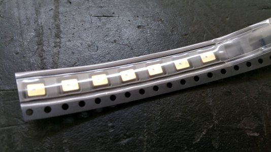

So after replacing the microphone i had audio again on the left side when recording in landscape. but the sound was of lower volume. Must be the microphone i ordered because its a replica.
Then took an old 520 with eMMC problems and took the mic from that one and soldered it on the 930 and guess what, all is good now. All call functions function properly in normal and speaker mode. Video in portrait has audio again too.
Wish i did this sooner....
So there you have it guys, no need for a new mainboard just a new mic.
