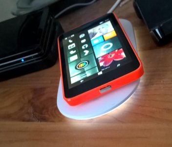

Guys - it's potentially possible to add Qi for just $16 with some minor modifications to the case - I'm about to attempt it with a receiver I got from Amazon using my 635.

It looks like you need to make the hole in the bottom of the 635 cover slightly larger to accommodate the connector, but the receiver itself works like a charm - I just tested it .
I'll post pictures of the 635 when i'm done.

Awesome! glad it's working. I do hope they can make one that takes advantage of the prongs that the 640xl has...
Please keep us posted. I have a L635 and would LOVE to be able to do this.
So this does prevent you from hooking your phone up to your PC using the USB port. Eh... a small price to pay, especially since I have Wi-Fi and can connect that way, or with Bluetooth.
However, I'm concerned how much of a problem it would be with the part sticking out a bit. Seems like it could get something broken, especially the way I handle a phone. How much does it stick out, exactly? In millimeters if possible.
I'll measure it - it's not that much, maybe a couple of mm?. I didn't even give it a second thought to be honest. i don't see it getting snagged on anything - mind you, I'm a chick, so I won't be putting it in any pockets!! :)
I was thinking it would be great for my wife's 635, too. I'm more afraid of it being snagged on something in that purse of hers.
so I checked it again. It's less than a millimeter. basically imagine you were to put a little boot over the usb connector to prevent dust, and that would be about how much it sticks out. That, or it's like you've put another button on the base of the phone. plus it's made of metal, so it gives it a little bit more of a luxe feel to it over plastic.
