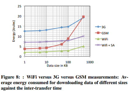

Actually, all of that micro management is at best a complete waste of time, and at worst counterproductive. Even under WP8.0 you should always leave both on at all times. WP8.1 didn't change anything about how these work, it's only changed how the current communication state is displayed to you on the screen.
Caveat: that is the theory. I'm not going to claim that this always works perfectly. My point is, the only time you should ever need to do any of that is when a particular device isn't working as it should, be that due to hardware issues, OS malfunctions or poorly programmed apps.
Why?
If you aren't using your device, it's not really active. It's just listening for incoming signals which occurs pretty much for free in terms of power usage. Many people believe they are increasing batter life by turning WiFi off, and on some faulty handsets it actually can, but if everything works as it should, doing so achieves nothing.
Actually, turning WiFi off, while you'd have WiFi access, actually reduces battery life. A few people have gone to great lengths to test this. They all reached the same conclusion. Connecting to the internet is something every WP device does quite frequently, even when it is not in use. Forcing the device to connect over cellular when a WiFi connection is available uses more power! Leave WiFi on and you will use less.
Turning off cellular data saves you absolutely nothing. The radios go into a sleep state and can be remotely woken up from a cell tower. The difference between sleeping radios and turned off radios are, in terms of power draw, completely irrelevant. On the down side, turning radios off will often cause you to receive notifications late, or not at all. A lot of users complain about not receiving notifications on WP in a timely manner, not realizing that they themselves cause this by turning cellular data off.
