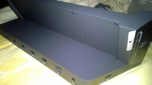

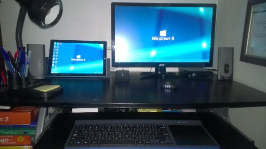

If you're paying real close attention, you'll notice my MiniDisplayPort to DVI adapter is plugged into the side of my SP3 instead of in the docking station itself... and that's because it doesn't seem to be working any other way.
The weird thing is that these are all the same connections I used on my Surface Pro 2 docking station and I never got a single problem out of it... but on SP3 it gives me all the device connected sound while my monitor reads "no signal" shortly before going into power saving. I go into resolution settings to assure it's seeing my monitor and it is - it picks up as a Acer G236HL and shows me that it is outputting at the recommended 1080p resolution.
Even tried a couple other 16:9 resolutions... but the video output absolutely does not seem to work when plugged into the docking station. What could I be overlooking here?
