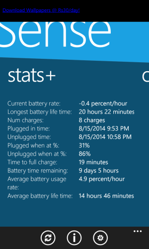

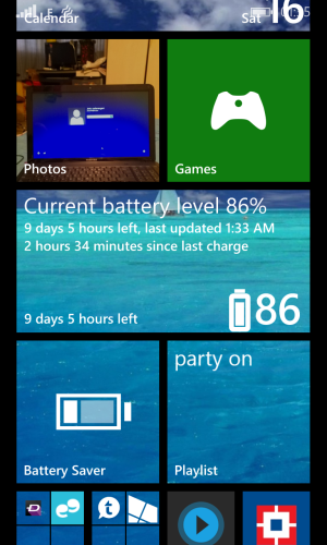

jeetu4444
Trusted Member
Sep 3, 2013
596
official l cyan has way better battery life compared to 8.1 dp....I downgraded to 8 and the to official 8.1 and cyan...tho your phone is very new it will take few more battery cycles...and set mail to every 3 hours or soo. stop apps using your location for no reason...after getting just 13 to 15 hrs...now suddenly battery life has reached 20 to 1 day with decent use
