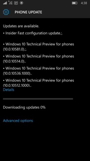

I'm having the exact same problem with my Lumia 930, stuck on 0% and wont move, I left it for hours, hoping that is gonna start but still nothing, Here's a screen shot showing my screen on PHONE UPDATE.
Please any solution, my phone build is 10.0.10166.0
Thanks.
Thanks.
I'm on the same situation .Did you got any fix ?
I was only able to fix mine by doing a hard reset. I didn't have to roll back, but did a hard reset. After the reset, it appeared to be stuck on 0%. I left it for about 30 minutes, and it suddenly went from "Downloading updates 0%" to "Preparing to install 0%".
The progress bar does indeed lie.
eveyone. Update 10.0.581 neet the wifi to update 100%. Not use data sim. And if not update. Use windows recover tool to fash Windows phone 8.1. This 581 version is the batterry on standby mode better than last version.
after flash to wp8.1. Go to store down load Windows insider.. Select fast ring. Reboot phone and check update by wifi to down 100%. If success thank me.
were you build 10166?
Nope. I had downgraded to 8.1 first and had a clean reset of WP8.1 Update 2 before attempting to upgrade to 10572. The upgrade to 10581 was directly from 10572, but would not work until I hard reset the 10572 build. I did not initially hard reset after getting 10572 installed, which may have been the issue.
