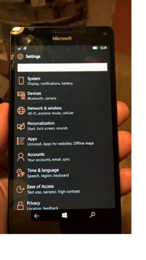

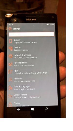

Reporting back here. I did some digging into a Nokia 1520 and found the registry keys there under the Display\Color and light\Brightness app. I added them back and had to add a Display folder with colordata.bin file in it to the Lumia 950 under the shareddata directory, reinstall color profile, and then toggle with InteropTools the manual brightness slider tweak. After this when I open the Color Profile app I have the Brightness Profile Back. Remember that setting? Now it does not work the same as before on the older Nokias, where I get this huge bright ness boost when sliding it but if I set brightness to Automatic it works the contrasting on the blacks, grays and whites so they are much more noticeable. The white point is more apparent now...It does not honestly help me a ton if I am in direct sunlight, but it is better than it was. If I am outdoors moving around or sitting in my car it does however.
Not that anyone would want to go through all this to make it work, and I am not sure why Microsoft has removed a lot of the settings here, but at least we know it is not some hardware issue.
Edit: I did more comparisons. Having now a 1520 that does much better in sunlight then the 950 XL does on the latest build of the OS I found some deltas in two other areas. One was in the oempanel.sys driver/service. The other was in the Color and Light static properties. I updated them to match the 1520 and tested. I attached what I think is a better result of readability and brightness. But I will test it this week to see how it really holds up.
