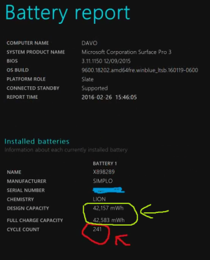

Hey guys! I have a Surface Pro 3 (i5 128GB) for almost 2 years and my battery started rapidly loosing capacity (mWh) in March 2016.
Screenshot from February 2016 https://1drv.ms/i/s!Aqc6Y3QdNzHPpL4r65mCFB6GeRB7CA (about 10hrs of battery life)

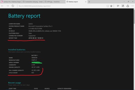

In middle of June i had only 26,000mWh and battery life was about 5hrs. But then... Capacity of battery started gaining again..
Now I have 39,000 mWh, and the battery life is again about 9hrs. WTF ?? How is that even possible ? Here are screenshots from last 2 days. https://1drv.ms/f/s!Aqc6Y3QdNzHPpZR8B6ObEUhKzZeMlg https://1drv.ms/u/s!Aqc6Y3QdNzHPpZR_Iv8Alp06uSmgEA
Now after some days I have 42,583 mWh on 602 cycles :-)
How to FIX:
For Two weeks use your surface only on charger. If you run your surface on battery, don't drain the battery under 85-90%! After two weeks you should see increase of your battery capacity.
That's all :-)
I'll hope you will be lucky as me, and you get your normal battery capacity back :-)
Good luck!!
Screenshot from today
Have anybody tried this method ? If yes, write here if it works or not :smile: You should see first improvements after 2 weeks.
