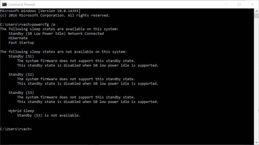

5. Open a command prompt and type powercfg /a. This is what you should see:
The key is the very first part - Standby (S0 Low Power Idle) Network Connected. This indicates the SP4 has properly working Connected Standby
On my SP4, HKEY_LOCAL_MACHINE\SYSTEM\CurrentControlSet\Control\Power\PowerSettings\54533251-82be-4824-96c1-47b60b740d00\8baa4a8a-14c6-4451-8e8b-14bdbd197537 is still '1' and it is working fine.
