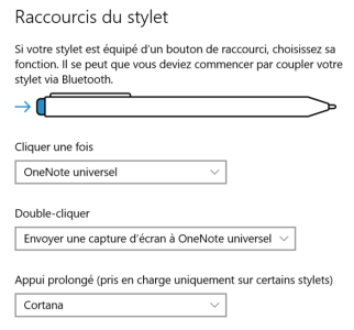

Actually, the button (top one) can be customized?on SP3.
Before I switched to Insider Program, having installed the SP4 drivers for the pen, the button was customizable in the Surface app (see http://www.windowscentral.com/microsoft-now-lets-you-customize-buttons-surface-pen)
I am an insider and have the 14366 version installled (thenstable version will be rolled out this summer as Anniversary Update -July 29th?-) -
In this version, the button of the SP4 pen used on a SP3 can be customized through the Settings=>Devices=>Pen and Windows Ink
(see snapshot below on a feench version).
Note btw. that younoriginally could configure the button to take a snapshot saved in your pictures/snapshot folder...
This is not possible?anymore as such, You can however send the picture to OneNote (and there is now a very convenient Windows Ink Workspace desktop addin that ehelps in this task)
