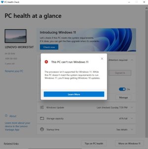

Checked the system requirements of my workstation and it says "This PC can't run Windows 11". Processor not supported. Why? Core i7@4.2GHz processor with 64 GB RAM. Specs attached... Windows_11_no.jpgWindows_11_my_specs.jpg
Please check that your system have TPM 2.0 (Trust Platform Module). If yes then enable it in your BIOS. Your problem will be solved.
Thanks. I checked in the device manager and TPM 2.0 is working properly. I just wanted to see if my system was compatible with Windows 11 and was surprised to get the message that the processor was not compatible. Maybe Microsoft can fix this in the future, so it's easier for people to check without going into the BIOS and changing settings.
Here's more info. I have Core i7. Right now, I guess, it is only Core i8 and above, but they are considering adding i7...
https://www.windowscentral.com/microsoft-open-lowering-minimum-cpu-requirements-windows-11
Just to be clear b/c you're conflating the tiers and generations: the initial Windows 11 reqs are 8th Gen or higher and yours is 7th Gen. The tier doesn't matter; 7th Gen i7 = not supported, 8th Gen i3 = supported. 7th Gen, maybe others, will probably be tested so there's a good chance your PC will end up being eligible.
