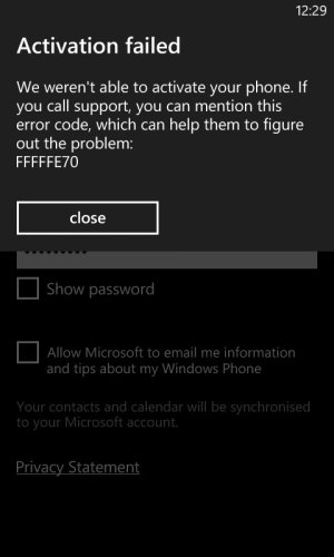

We are facing internet connectivity issue in a new lumia 620. Data is activated. We are able to see the store contents. But when trying to sign in to microsoft account it shows, activation failed. Please find the screenshot. Does anyone know the resolution?

Hard reset your phone then add your MS account again. Also sync your time/date with MS server.

I had the same issue when I was trying to connect to my microsoft account. A hard reset fixed it so that is your last bet.
how to hard reset :(
If you can access your phone desktop, got Settings>About>Reset Your Phone.
If you can't get to the phone OS, first press and hold the Camera + Volume Down + Power buttons simultaneously. Release the Power button when the phone vibrates - but continue to hold down Camera and Volume Down. Release the camera button and Volume Down when the Format prompt is displayed on screen. Then press Windows button twice to confirm.
