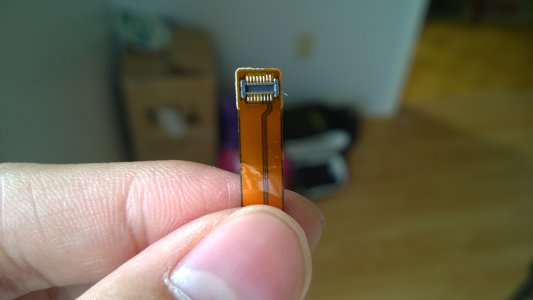

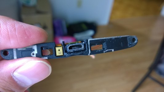

What you may be wondering, is what caused the melting in the first place. Well, I was in the same boat as you too. After I replaced the damaged part, I have done some investigating on the damaged USB cable. To my surprise, only the USB port itself is melted, as shown here:

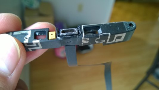

And as you can see in this picture below, the connector remains intact, with no damage at all.
So in the end, it is not a hardware issue because everything else is in good condition - so Nokia's reputation is still regarded very high. This is why I love Nokia. I wouldn't know what else to do if they ever stopped making phones.
It is also not because I have changed the shell. Numerous people have pointed this out. I have changed the shell numerous times after my warranty ended, and it didn't negatively affect my phone's performances. If you look at the pictures above, the actual USB connector has two screw holes at both sides, meaning that when you place back in a shell, you would have to put back the screws in, and all the times I swapped shells, I made very sure to put back the screws in very tightly, so there's no way for the port to be loose - not even the slightest.
Since I have ruled those two possibilities out, I have come down to the conclusion that the night my phone melted, I must have "loosely" plugged in the charger before I went to sleep. And I think that's what have caused the port to short circuit, causing it to burn and melt.
