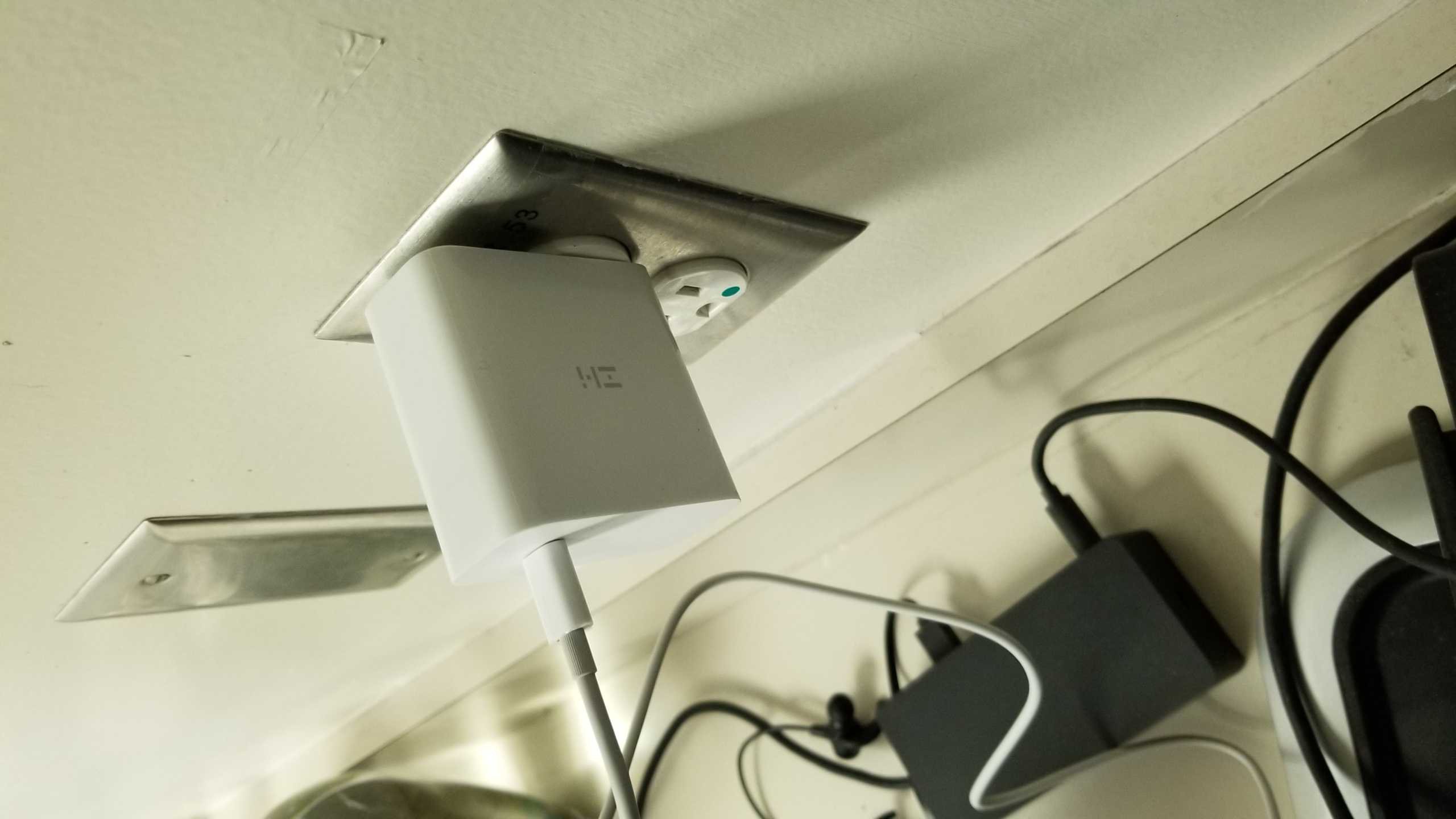

So I got this charger and it charged pretty quickly from 17% to full in over 2 hours.
https://www.amazon.com/gp/aw/d/B071...ag=hawk-future-20&ascsubtag=UUwpUvbUpU3756057

What wattage charger are you using? The OEM Surface Power supply is 24W, and they reccommend 29W + in order to charge via USB-C.
If you're using a cell phone charger I GUARANTEE it's too low wattage. I haven't seen a USB-C phone charger supply over 15W and even then, it has to be USB-C PD spec (power delivery). I have a LG brand USB-C PD 15W charger and it will do about 1% every 2 minutes when not actively using.
