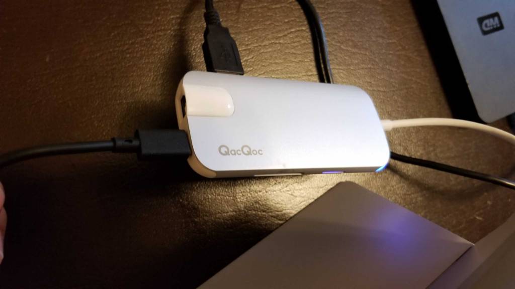

So I am using a USB-C hub I also use on my Surface book 2.

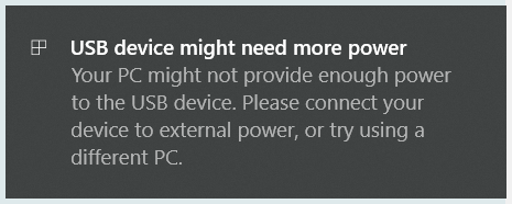

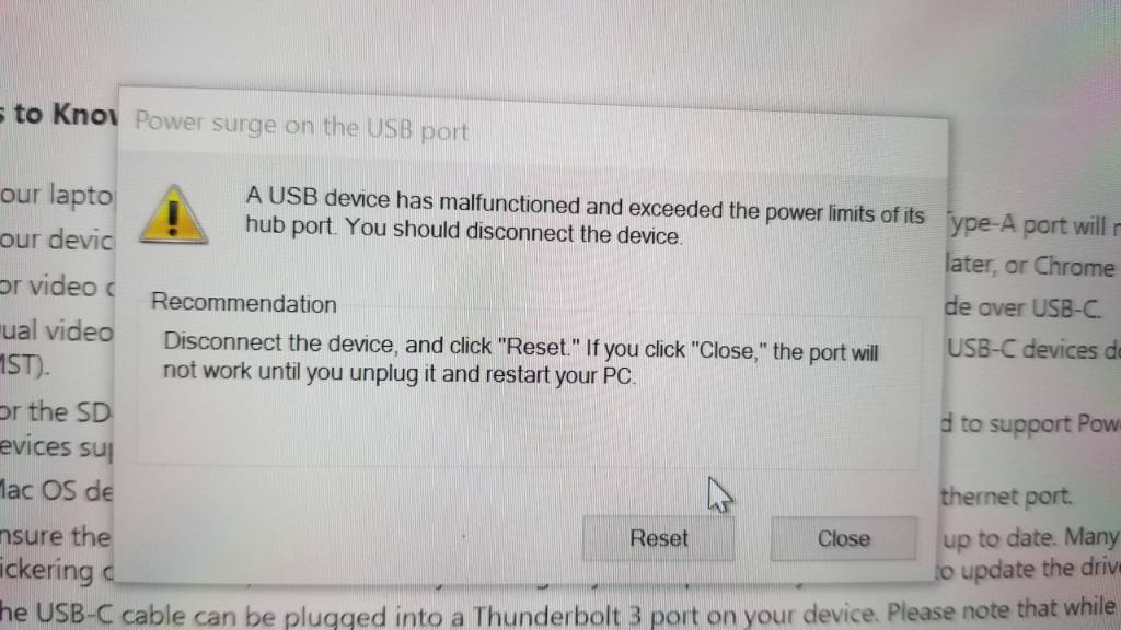

I get his error that the hub cannot supply enough power to connect my simple external hard drive.
Faulty port?

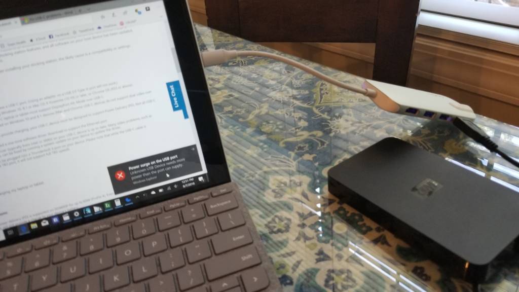

When my Go is plugged in to power (using the surface dock), the hub works.
So it seems it will not work if just running on battery?
Can anyone else confirm?
I can confirm that when I plug a USBc cable for power, the hub works fine.
So there is a difference in the power draw of the Go and the Book 2.
My Surface Go connects to my external hard drive fine through a simple USB-C to USB-A dongle whilst unplugged. May be worth trying that rather than a full-on hub.
