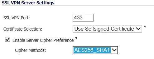

So this will work. But the problems are the encryption and a custom port. So on the firewall if you set the SSLVPN port to a standard port, IE 443, and Encryption on firewall in SSL server settings to AES256. It will work. At least it did on my NSA3500. Oh and I think you have to setup ip ranges in the mobile connection to get to your internal networks. Still testing all of this.
I wonder if there is a way to bind a custom port to this mobile connect crap?

It can work. But its not very stable. Your sslvpn needs to run on port 443. I think aes encryption. And you need to create routes in the Sonicwall client
This does work. I swear. Incompatible VPN comes from encryption not being aes. Port 4433 will not work, the only port that will is 443 because you cannot use :4433 on the mobile client. You need routes on the mobile client for internal networks. It is flaky though and Sonicwall support is worthless on this issue

1) Yes it's running on my Lumia 635 with SonicWALL Mobile Connect Plugin
2) I use the port 443 which is configured at the SonicWall (Menue/SSLVPN/Server settings)
At first I got the same error but after switching the cipher to AES256 (Menue 2) ) it worked
