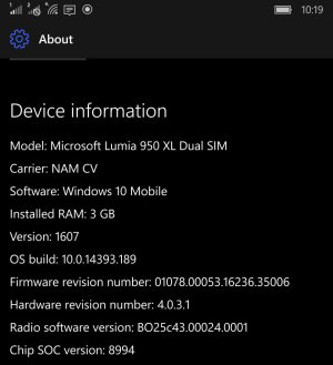

I got an phone update overnight to OS build: 10.0.14393.321. Maybe this will help.
