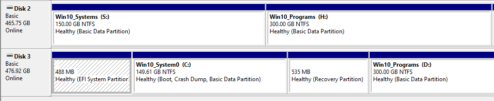

SSD1 is Disk3 in Windows Disk Manager (please see the attached picture).
So I reinstalled Windows 10 on SSD2 and all the additional software.
SSD2 is Disk2 in Windows Disk Manager.

Could you show a picture of your boot options in BIOS? Do you have fast boot enabled? Have you tried disabling fast boot?
Thanks Laura, it's solved already.
The culprit was the Fast Boot that I don't know how or when it was enabled (I can't remember enabling it). I ended up with clean installing the OS, since I think there were some other mistakes in the previous installation.
