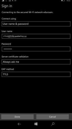

Sorry for not responding sonnet, I was away from campus for holiday until now. So today is did be able to connect my campus eduroam through TTLS too.
So click the table of EAP method, then you can chang eat from MS Chapv2 to TTLS. See if that would work with your university.

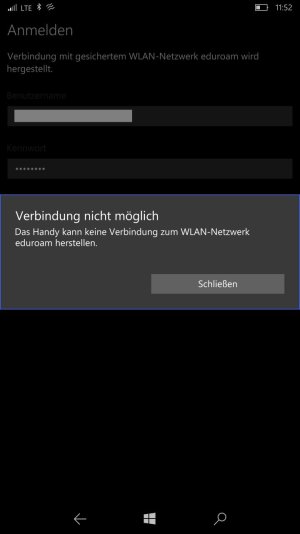

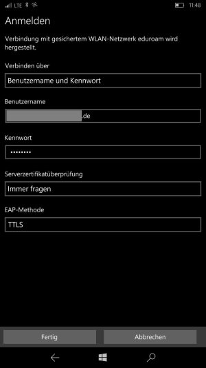

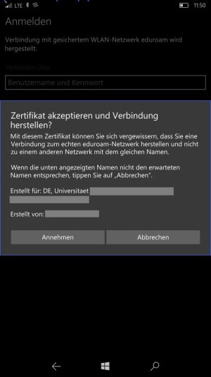

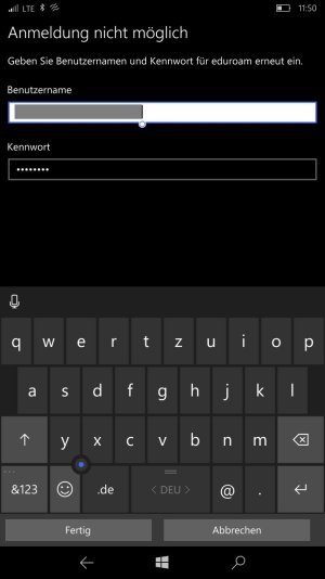

No, it does not. I can enter my username and password and am asked to accept the certificate. Then I'm told that authentication was not possible (I think that's due to the lack of PAP-support) and can reenter username and password once more before I get the message that the attempt to connect to eduroam has failed. See also attached screenshots.

You all have to understand that the authentication method is determined by your eduroam account PROVIDER, and NOT the location you are trying to use it. So if your home institute uses a method not possible to enable on your phone, it doesn't matter where you are, it is not going to work. Whereas if your home institute uses an other method it is going to work. I have the same issue: the institute supports EAP-TTLS / PAP, and while win 10 supports it, there is no way to enable it in W10M! :( You can push this setting using mobilde device management (which I / we don't have) but you cannot enable it. To repeat: the system supports it, you just cannot tell said system to use this specific method because nobody at Microsoft bothered to add a checkbox to the GUI since _YEARS_.
