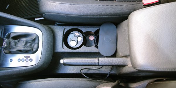

I wanted the ease of wireless charging in my car and being free from the wires, plugging in everytime I get in/out, and most 12v adapters output 500ma, which isn't much power and slowly charges it.
I ordered an extra charger/dock in hopes it would fit in my cupholder (DT 910), but it doesn't. I decided to use my DT 900 for my car and dock for home.

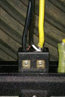

Luckily the charger takes 12v. I looked at the plug and it's 12v and 0.75a. I cut the wire, and screwed it into an amp I installed earlier. Positive to positive and ground to ground. I plugged the other wire to my charger and now it works in my car! Works great and it actually does recharge about 5-10% battery on my commute. Better than nothing and will help on longer drives!
Keeping your phone to stay on that flat surface doesn't worry you? What if you have to stop fast or take a sharp turn? I'd be afraid of my phone sliding off that and landing between the center console and the front seat

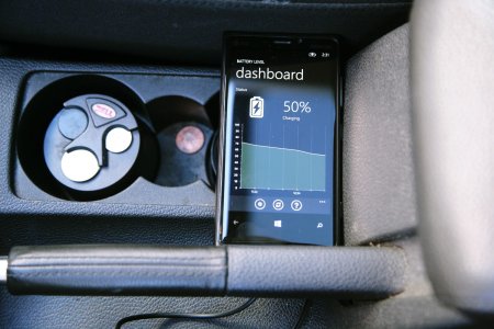

If you look closely you can see the phone is snug between the handbrake, seat, and center console. It really slides right in and stays put. Hasn't moved yet despite sharp turns. The only possible movement is forward if I slam on the brakes. If I have to slow down that quickly, I probably got other problems than worrying if my phone is by the shifter.
Anyways, I can really attest that with my phone/car setup, it really fits very well and I'm 100% confident of it. I was initially worried about how to arrange it, but it is perfect! If you got a VW golf/sportwagen and a 920... go for it!

People were wondering about how to do the power. Just cut the cable and pos to pos and neg to neg somewhere in your car. I attached it to the amp under my seat and the connection is shown in the picture.

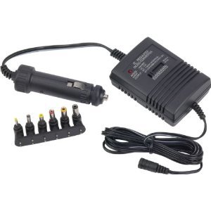

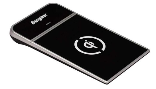

I want to do this as well. I was thinking of using the Energizer Qi Charger and a non-slip pad on top of it. It's good to know you can just hardwire it, because I was initially looking for a 12v universal auto adapter (I found one on Amazon).

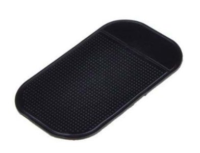

I think I'm going to put a non-slip pad on top of it and just mount the charger using strong double-stick tape. I can just sit my phone down and it'll charge. I'm going to have to see if these Energizer qi plates are 12v power in as well.
Amazon.com: Energizer Single Position Inductive Charger: Health & Personal Care

Amazon.com: Black Car Sticky Dashboard Anti Slip Mobile Phone Mat Holder: Cell Phones & Accessories
Unnecessary if you hardwire it:
Amazon.com: Universal 12 Volt Adapter 1200 Ma: Cell Phones & Accessories
