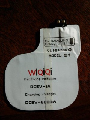

Yup. This adapter works like a champ for me...

Yep. It works. I just purchased a newer super thin one from Amazon and it works perfectly with the ATIV. It also eliminates that bulge of the back cover because it is thin. I tested it with my LG, Nokia and TYLT wireless chargers and works perfectly. I also have the S4 battery and white external charging case and both work perfectly with the ATIV. The only issue will be with cases but Incipio already has some out that Verizon is selling. I am waiting for the Incipio Feather case because I know those are thin enough to allow the wireless charging to work properly. Here is the charging insert that purchased.
Amazon.com: Qi Wireless Charging 0.5mm Receiver Card Coil for Samsung Galaxy S4 SIV I9500 I9505 with Full NFC Support: Cell Phones & Accessories
