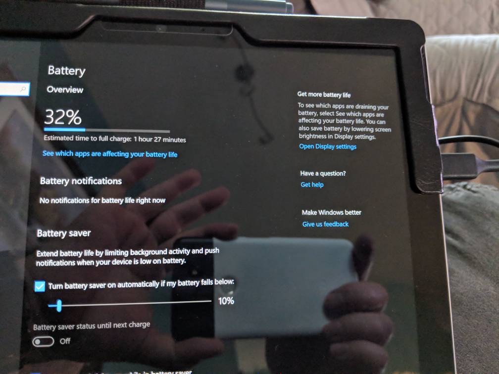

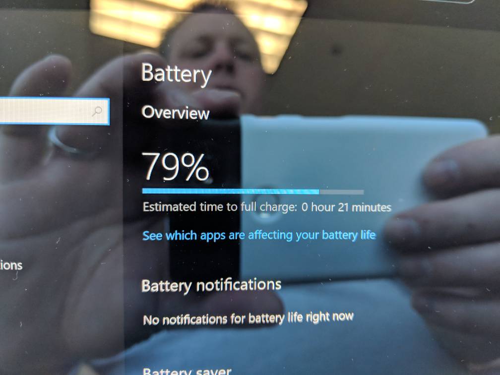

I know this was solved, but just an FYI I purchased this power brick and it works well. It charges pretty fast, but not as fast as the factory charger.
https://www.amazon.com/gp/product/B...ag=hawk-future-20&ascsubtag=UUwpUvbUpU3759699
With Power Brick listed above:

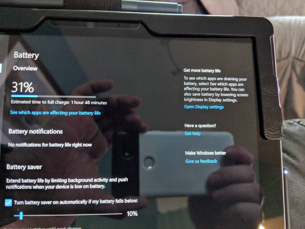

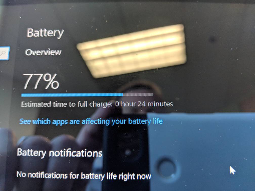

With a Surface connect charger (not the factory one just one I had sitting around) 15V 4A):
I don’t see that as being much (if any) difference. 24 minutes to charge from 77% to full (23%) or 21 minutes to charge from 79% to full (21%).
Ok...one more test... The adaptor above vs the factory charger. Looks like the USB-C adaptor was faster than factory.
