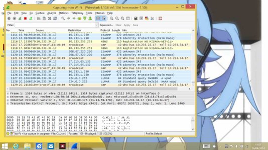

OK so I have been trying to figure out why I can not put my Lumia 928 on my primary network so I can control plex, every time I connect it to my network (Misaka Network or Misaka Network (High Speed)), this network has a AD domain on, local DNS (not anymore now using my utm for forwarding), IPsec encrypted from PC to PC and all that (this was done a week ago) it will then says it has no internet and will not load anything or does it as slow as possible! So I connected it on my secondary network (Level Upper Network) which as no domain or any thing between it except for my UTM and the gateway and then all is fair!
I have tried to wireshark the secondary network to see its traffic but what do I see? Not 1 packet from its ip address
Here is unfiltered

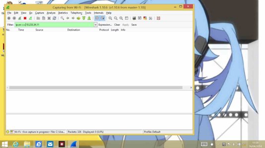

Here is filtered but my WP ip

So how in the world is it talking to the network??? its not using my DNS I know that!
first, to have an AD domain, you have to have local DNS. Second, if you are using IPsec from PC to PC, I don't think the phone will be able to talk to your DNS (unless you also allow that connection to talk to your LAN unencrypted), third, are you doing any enterprise wifi associations (radius, certs, etc)?
my local dns is now on my firewall which has a domain override on it to send requests to my local dns, everything else goes to 208.67.222.222 (OpenDNS), same rule applies to the secondary network
my IPsec rules at currently set to request encryption so its not required, but only recently have I done that long before that it was all unencrypted
all wireless is currently WPA2 Personal
ever sense I have had a WP I can not have it on my main network and I have to use my old android phone to control plex which is very sad
but still where are its packets???
WPA2 TKIP or AES? Does the phone say you are connected? Do you have a MAC restriction? If the phone works fine on your other network and any other networks, the troubleshooting points to an issue between something on your network and the phone. I would have to guess your fairly non-standard setup is not working well with the phone. , either something in your WiFi configuration or how the network is trying to pass packets that the phone doesn't like or can't deal with. Dial back the WiFi settings till they are as basic as they get and make sure DHCP is working correctly and not sending any odd options to the phone, if that works, dial it back up till it breaks. Really, if this is your home network, tune it back a bit. Playing is fun, but I'd rather have my network working :P
