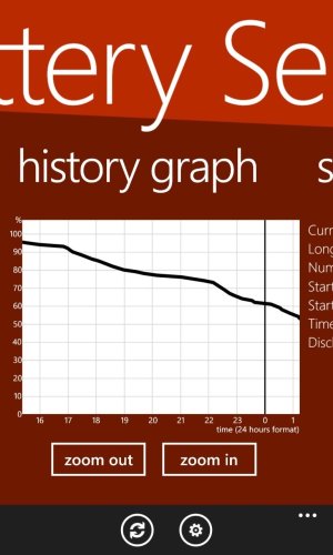

Okay, so after browsing the net, checking fb, twitter, and other social sites at least every 20 mins, taking pictures(lotsa 'em), and talking on the phone for almost 2.5hrs. In short, moderate use. I got this result. Follow the one posted above and you might have the same result.
pretty impressive!
Btw, I'm currently doing another test (I've drained the battery last night and charged it overnight) ) to see if the battery will perform better. I'll let y'all know the result later. ciao
I looked at this pic on my Lumia and kept wanting to hit the buttons and swipe.

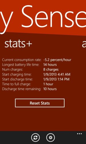

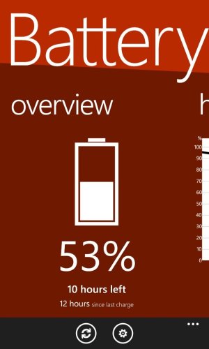

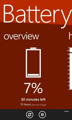

haha. You migh want to see these pictures below!
As promised, here's the result after draining the battery and charging up overnight. I have no intention of putting my phone back on its wireless charger tonight because I'm pretty sure that my phone will still be alive when I wake up tomorrow morning.
So yeah, turning off the music hub did the trick for me, and of course, draining up the battery.
I did the usual, but I didn't talk to any of my friends for almost 2.5 hours. However, I'm connected to my phone's hotspot for more than an hour now. I don't know if that counts though.
Also, I've received some complaints from some of my friends that my phone keeps breaking off during phone calls, but I've figured that it wasn't because of the phone, but rather my network connection. For some reason, I only get about a bar in my signal(pretty much every spot in my house except my room) and I've figured that was causing the problem. Other than that, I'm pretty satisfied with my first Lumia phone. As I tell me friends, 'I'm not faithful because I've used other smartphones before, but I always be loyal to Nokia!' Having been used: 5110, 3210, 8210, 6600, 6220, N82, N97, and Nokia 97mini, I must say that Lumia 920 is Nokia's best smartphone to date! Y'all agree?hehe
