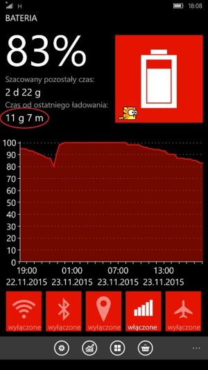

maydar
Nov 22, 2015
9
Visit site
On my L1520 with 10586 battery drain is a little higher than with 8.1. After 11 hours of using, few calls, messages, using as flashlight etc. battery down to 83%. I think it's good result.
