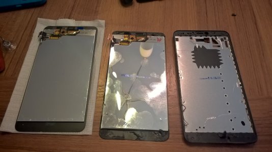

One of the worst problems facing the Lumina 640xl right now is people who've been cursed with the yellow stained screen. After being unsatisfied with trying unsuccessfully to get the screen replaced either through warranty or even a repair place recommended by Microsoft themselves, I went to eBay. I didn't know what to expect, so I just ordered the cheapest touchscreen replacement I could find.
As it turns out, there are 2 options. You can order the touchscreen, or you can order the touchscreen assembly. The touchscreen assembly appears much easier to deal with, however, I didn't know this. I ordered the cheapest option which is just the touchscreen. Don't do this. Order the touchscreen assembly, if you're brave enough to under take this endeavor.
Ordering the touchscreen assembly prevents the next step:

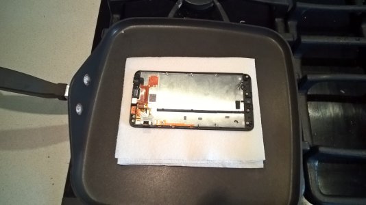

I didn't have a proper heat pad, which is needed to make the black adhesive at the corners of the screen become sticky tar like substance. I settled for this, and then I then used my CRKT KISS pocket knife to pry the screen from the black plastic frame.
Once I got the screen off, I went ahead and connected everything back together. Because I'm lazy, I didn't bother to find the black adhesive to keep the screen on, so now I have a screen that's not really connected to the frame, but its in. And NO yellow spot!

Can you post a link to the eBay seller that you purchased your screen from?
I could, but i wouldn't buy that particular touchscreen. I bought just a touchscreen, and there are sellers that list the touchscreen assembly. it's more expensive, but it is well worth it for avoiding the heating part that i had to do to remove the original touchscreen.
i bought a touchscreen similar to this, though:
https://rover.ebay.com/rover/1/711-...er-Assembly-/271906689571?hash=item3f4ee6d223
I wish I would have bought a touchscreen assembly similar to this, though(note it has the plastic frame with eyelets for attaching the bolts back:
https://rover.ebay.com/rover/1/711-...and-00813P1-/151643669409?hash=item234eaac3a1

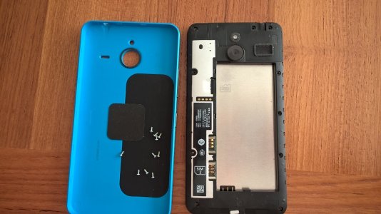

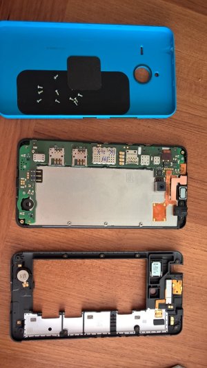

Would you mind walking through all the steps? If I'm following correctly: 1) remove back cover, battery, sim card(s) and microsd card. 2) unscrew the 10 little hex screws (how hard was that?) 3) It looks like there are basically three "layers": a) plastic 'bracket' that holds the sim card(s) and microsd, that looks like your third piece in your second picture b) microchip wafer and c) screen assembly. How hard is it to 'connect' and 'unconnect' the three layers once the screws are out? How does the screen assembly attach to the microchip wafer layer?
I want to do this for my phone, since Microsoft won't fix it under warranty. I am fairly capable with electronics (I built my own PC for example). Just wondering how hard it is. Let me know your thoughts! And I'll definitely take your advice to get the full assembly.
Building a PC expertise not equal to separating assembly from the plastic frame !
PC=big
phone=small
removing the screws is the easy part !
always use gloves while touching internals and make sure there is no static on your hands/body !!! (ground your hands/body)
The heating should be uniform and not hot enough to fry the chips attached to the assembly. (there are IC's attached to the display + touch-panel unit).
If you can heat only the part where the glue is, then it would be safe.
Prying it apart is the next hard thing (without breaking the plastic frames, sockets and plugs, without making scratches, etc)
Ultra-Ultimate patience is required for a job like this !
from the pictures it looks like its only display + touch-panel and no frame.
phones nowadays have display and touch-panel glued together as a single unit !
If you get the (display + touch-panel) already-glued-on-to-the-frame-unit then it will be an easy swap !
