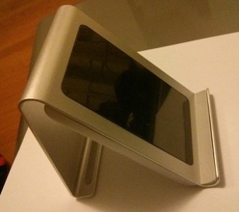

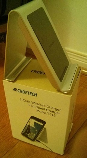

I own the Choetech 3 coil wireless charger as well and I feel that the glance feature on the Lumias makes it great to have a "stand" style charger as it makes it that much more convenient to just be able to take a quick look and know if you have any notifications.
Quick summary of pros and cons:
Pros:
-Compatible with variety of phones
-3 coils allows for greater charging area
-Premium look and excellent build quality
-Stand design is convenient
Cons:
-Wish that the USB power cable connected to the stand from the back rather than from the side
Here are some pictures:

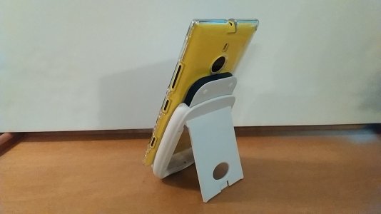

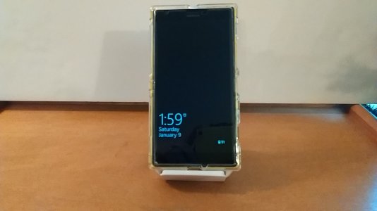

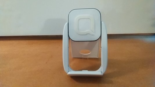

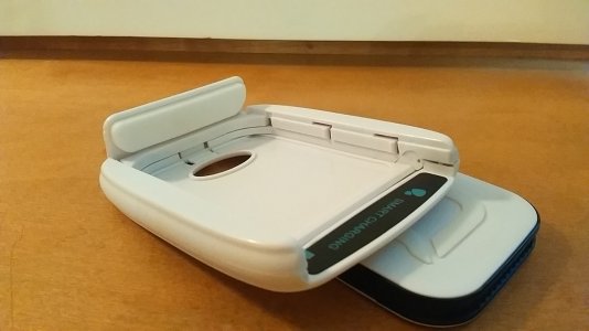

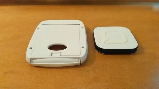

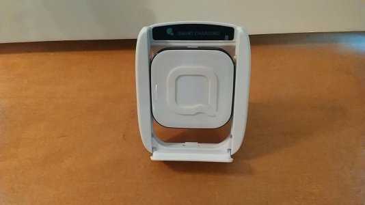

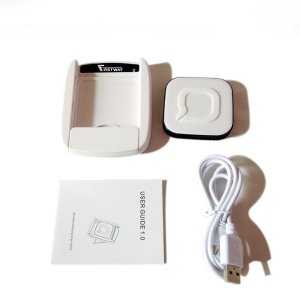

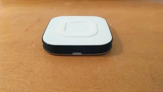

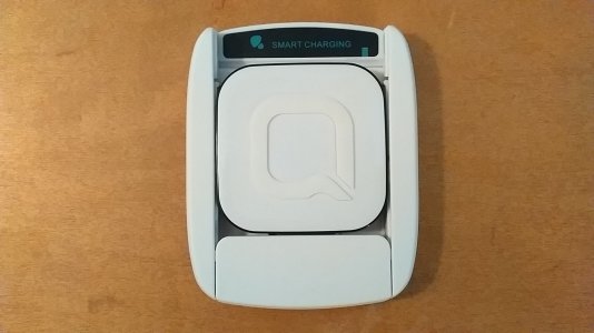

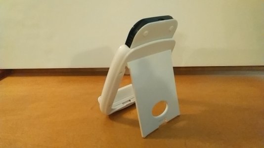

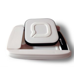

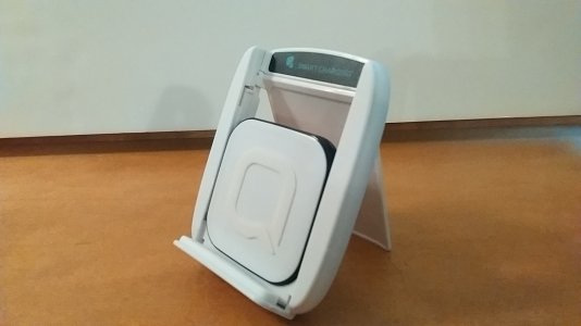

Here is my hands on with the Firstway Qi Wireless Charger Foldable Kickstand Qi transmitter pad.
The adjustment range is fantastic. For reference I have my 1520.3 on there which is a big boy phone. You can see just how far up the stand the Qi pad will sit (too high up for 1520, but probably well within range for 950/XL) and how far down the pad will rest.
The pad has click-slide adjustments at all stops throughout the range and allows you to dial in the pad for your phone.
The shelf/phone rest is nicely padded and so is the Q symbol on the pad.
Due to the height and width of the stand, my 1520 is way more stable under input than it ever was on a DT-910.
You could use the pad alone as a lightweight travel charger...
...or fold the kickstand in and use the whole rig as a generous sized charging pad.
The kickstand folds flat and clicks securely in place. The whole package is not that thick and it is pretty light in weight.
With the Q symbol in the upright position the LED lights (one green for power, one blue for charge status) are pointing straight down at the stand base and the microUSB port for attaching the cable is facing up. I'm running mine with the Q symbol upside down (does not affect charging) so the cable comes out downward and is routed through the cutout hole in the kickstand. The LEDs are facing up, but the phone blocks them.
It charges my 1520.3 through the clear snap-on case I run and also charges my wife's Nexus 6 through a dual density case. Note that the DT-910 never would charge the Nexus 6 in the thick case it wears. For the Firstway we are looking at, the charge on N6 through a case was a bit slow, but acceptable.
The Firstway comes with a very short (24") USB cord and no power head. I mixed and matched a bit and used this Battery App to check charging rates. I settled on a 5vDC, 1Amp output charging block and a heavy gauge USB cable that I think(?) came from a Nokia somewhere along the line. Dialed in I'm achieving 22.5% charge per hour on my 3400 mAh battery. By contrast the DT-910 reaches 24.78% per hour. I'll take the small reduction in charge rate as a trade off for the increased stability and flexibility of the Firstway foldable kickstand and pad combo.
Color me happy with this purchase: Amazon.com: 2-in-1 Anti-Slip Rubber Ring & Separable-Installable Desktop QI pad stand Firstway? Qi Wireless Charger Foldable Kickstand Qi transmitter pad Wireless Charging for iPhone 6S /6 plus/6 /6S Plus/5S,Samsung Note5/S6/S6 Edge/S3/S4/S5/NOTE2/NO
