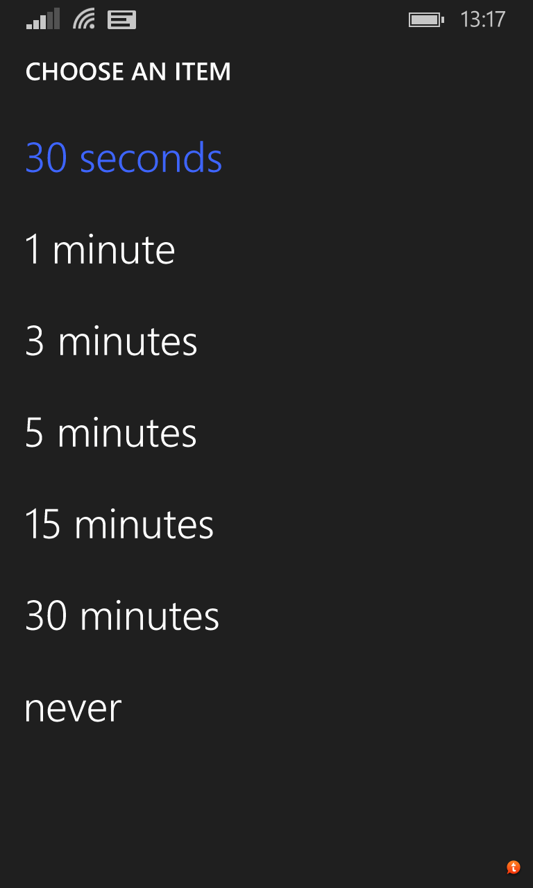

My screen goes black during phone calls too, even if I have the phone sitting on my desk. The proximity sensor is not being blocked. It's especially annoying when I'm checking voicemails or in an automated system where I need to use keypad to enter digits during the call. I have to push the power button to unlock the phone and even when I do that, screen only stays active for a few seconds and then goes right back to the black screen.
How long do you have it set for your lock screen to stay on?
