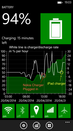

there is a screen shot, at the point the Nokia charger was plugged in (the only charger outside of the 2 times I have used an in-car one) the phone discharged, then began charging with this erratic charge rate. I had to intervene once as it had stopped charging and would no longer recognise the charger being connected. After the second time it just stopped, I switched to an iPad charger (in yellow) and so far, normal service is resumed. As you can see, nice linear ramp up to a plateau of 15%/hr, some 10% down on what I normally saw with the Nokia charger, but I don't care so long as its predictably going to charge.
Perhaps the nokia charger is simply being over driven or running too close to its limits? Normally it would power along at around 25%/hr.
