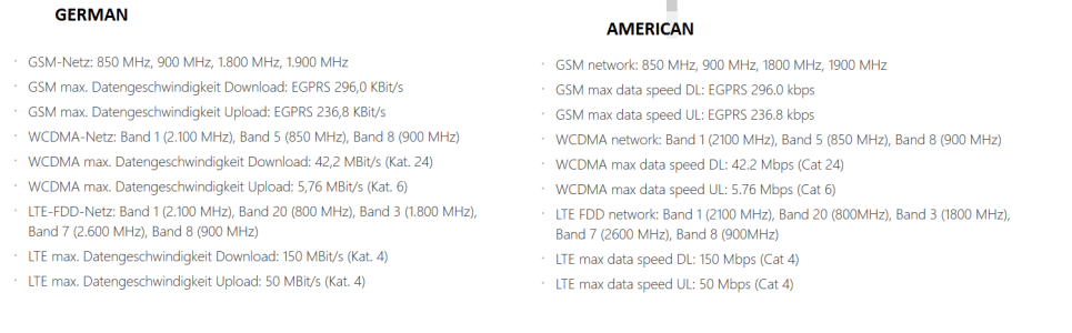

My brother is currently in Germany and could buy me one. On the official website they have a variety of different bands supported. Since ATT confuses me with all there different bands, I ask you guys. Does anyone know if the European 640 works at ATT in the US ?
I would not if you are getting an LTE model. I think it very likely that the 640 will follow other releases and have 2 styles of radio. A Euro style (which you would get in Germany obviously) and a radio for the Americas which you would need for ATT.
3G support might not even be complete. Here is a link to the 640 Dual Sim on Microsoft Store DE: Microsoft Lumia 640 DS kaufen - Microsoft Store Germany Online Store It does not list the 1900 MHz needed on the WCDMA (3G) radio for ATT to work. I can't say if it is missing or just not listed as unimportant in Europe where they tend to rely more on 2100 MHz.
Damn. I really hoped it would work. On the German Microsoft 640 website is under specifications the same bands as on the American one... so I assumed it would workbands.png
What you are showing as "American" on that chart is useless in the US for anything but EDGE speeds...
Why do you say that? It says it supports band 5 (850MHz, AKA CLR) in 3G. On AT&T that'll get you 3G speeds in many areas. It's also worth noting that it has LTE band 7, which won't work in the U.S. but *will* work in Canada, which could help some people (including Americans travelling to Canada).
Overall you're right that you really want PCS and AWS over 3G and LTE, so I'd look for a variant that has them.

I'm all for qualifiers where appropriate. I replied not because you recommended caution, but because you said something inaccurate. You said the person *would* get nothing better than Edge speeds. However, because AT&T has a lot of 3G on CLR, many Canadians and Americans *would* get 3G most places. AT&T has a lot of CLR licences across the U.S. Ditto Rogers, Telus, and Bell. Ditto many regional carriers. In many places, they only have CLR for 3G (especially in rural areas).
So I think the appropriate response to the person is that the device doesn't support all the frequency bands that you'd want for AT&T, and that might reduce data speeds or even hinder coverage. Promising they'll only get 2G is not a "qualifier" as you suggest, it's a specific statement that may or may not be true. So in effect I was replying not because you'd used a qualifier, but because you hadn't. :)

You should get 3G coverage. I believe the description on Expansys is incomplete. Microsoft's listing for the phone lists more frequencies: Microsoft Lumia 640 LTE Dual SIM Specifications - Microsoft - Global
To summarise:
2G Americas: 850 MHz (CLR) and 1900MHz (PCS)
2G Europe: 900 MHz, 1800 MHz
3G Americas: Band 2 (1900MHz PCS), Band 4 (1700/2100MHz AWS), Band 5 (850MHz CLR)
3G Europe: Band 1 (2100MHz), Band 8 (900MHz)
LTE Americas: Band 17 (700MHz MBS), Band 2 (1900MHz PCS), Band 4 (1700/2100MHz AWS), Band 5 (850MHz CLR), Band 7 (2600MHz BRS), Band 28 (700MHz MBS), Band 12 (700MHz MBS), and Band 38 (2600MHz BRS)
LTE Europe: Band 1 (2100 MHz), Band 20 (800MHz), Band 3 (1800 MHz), Band 7 (2600 MHz), Band 8 (900MHz), Band 40 (2300-2400 MHz)
For native T-Mobile coverage you want 2G PCS, 3G PCS/AWS, and LTE PCS/AWS/Band 12 MBS. For AT&T roaming, 3G CLR is useful (and T-Mobile actually does have native CLR coverage in one city due to an oddball result from an acquisition years ago). This phone supports every frequency T-Mobile is throwing at it. It also has every frequency you could ever want for Canadian roaming, including the additions of Band 7 and Band 38 BRS which are used in Canada (and in Europe and Asia as well in the case of band 7), but not in the U.S. unfortunately (thanks to Sprint).
