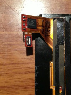

ok some pics. First up is the original digitizer connector/control chip. you can see the marking on chip very clearly

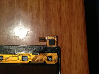

Then it's this replacement digitizer connector/control chip. the marking on the chip is blurry and iphone can't focus on it. also the plastic thing behind 3 keys are missing, but that's mostly cosmetic IMO

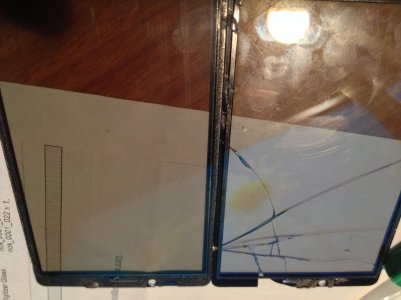

Side-by-Side on a white paper. Looks like the polarization layer is done right. But it is not...
