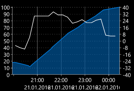

After having done very intensive QI charging tests with the Lumia 950 XL and various QI chargers I am pretty confident that this phone is only supporting the 1.0 standard which equals 5 watt charging power.
This video made me curious as well but now that I also own the DT-904 charger I cannot reproduce this at all. At the very very best I can achieve 3:30 hrs full charge which equals 5W charging power.
The interesting part is that the QI chargers I use draw between 8-9 watts (using an amperemeter) while only 5 watts arrive in the phones battery at best. The difference ends up as heat which then slows down charging speed.
Something is definitely wrong with the Lumia 950 XL QI charging. My other Lumias (930, 1020, 925) show totally stable flat QI charging curves with only a slight drop at the end of charging. The 950 XL charging rate is up and down throughout the whole charging cycle.
DT-904 QI charge 950 XL - no cooling: 4:30 hrs
DT-904 QI charge 950 XL - air cooled: 4:30 hrs
