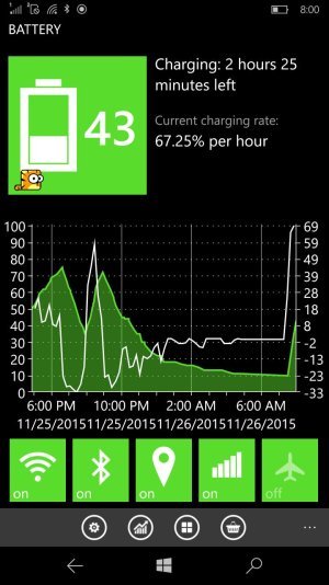

I also have the Lumia 950XL. I have used the DT-903 for over a week and was very satisfied with the charge rate although the phone did get pretty warm. However, yesterday and today the phone seems to only charge when the phone is cool. Let it get hot and I don't see much charging or at time there is no charging based on the percent of battery charge indicator.
I will continue to monitor and report if changed.
(update: I uninstalled my "Battery" app by Enless Soft Ltd and reinstalled it. Now the "Battery" app shows 100% app and in the phone Settings, System, Battery Saver, Overview heading at top of that screen! I had tried yesterday to upgrade the "Battery" app to pro and got an error from the developer saying a problem existed on their end preventing the upgrade. I just tried upgrading to the pro ad-free version and got the same message after another attempt. However, the "Battery" app still shows 100% and so does the Settings screen. I wonder if the phone was always at 100% but not showing it or reporting inaccurately to the "Battery" app?)
(update: Still the same problem. I charged it to 100% via the USB-C connector yesterday evening. I played podcasts unconnected during the whole night. This morning the battery showed 39%. Arriving at work the wireless charger (D-903) once again got the phone pretty warm and the charge indicated stayed the same. I removed the 950xl to cool and even turned it off. I noticed the battery charge indicator would jump a couple of percent after I turned the phone on. Then back on the wireless charger and again no change. Repeat removing it. Same jump later on when turned back on. Noticed the bluetooth wireless charger was "paired" not connected so I manually clicked it to connect which it did. So far I have repeated all the above steps with no change after getting the wireless charger to show connected with the same results. I still suspect the phone may actually be charged far greater than is shown but haven't had the time to test further.)
