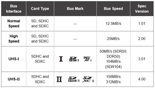

Been searching, but coming up empty handed. Does anyone have any info about the 950XL SD card bus speed? What is it's max read and write speeds for the SD card slot. Would be helpful when purchasing an SD card for it. Would be awesome if it supports the latest standard, Ultra High-speed v2, UHS-II.

I found out on another thread that the Snapdragon chips used in both 950's can only support Bus Interface UHS-I. After further research on my own it turns out that the new Snapdragon 820 being introduced next year also only supports UHS-I, so I get the feeling it will be awhile before we see a phone supporting UHS-II from any manufacturer.

At the moment UHS-II is not supported by nearly ANY device. Not even high-rated DSLR support that standard. Only few DSLR support that if i'm not mistaken. It's a quite recent standard and requires different hardware as they need more pins to read UHS-II so pretty much no manufacturer would have had any benefit. Moreover there are very few microSD UHS-II and these are quite pricey. Hence you can bet it will not be supported for at least 2-3 years on smartphones.
PS: if you want a good 128gb microsd you can get lexar 633x while if you want an even faster card switch for a 64gb sandisk extreme pro or sandisk extreme plus. These cards still afford good sequential speed and in particular for the two sandisk i mentioned they also reach nice random speeds.

According to the Lexar site, their UHS-II cards are backwards compatible with UHS-I devices. There appear to be several UHS-II devices available, and they are not much higher priced than the UHS-I cards. I believe I will look to purchase one of these UHS-II cards for my 950XL, it seems like they should work (at least according to Lexar).

just want to point out the (ostensibly) obvious for those who might wander into this thread: bus speed is not necessarily an indicator of overall card speed. Yes, you need a UHS-I card...but that is a necessary/not sufficient piece of the puzzle. You will also need to look at the speed class of the card as well. This will be marked on the card...and you want a "U3" card if you will be shooting 4k video. https://en.wikipedia.org/wiki/Secure_Digital#Speed_class_rating

I think what is being asked is "what speed SDCard will I actually be able to take advantage of?". I had this problem myself... you can spend a ton of money to get a really fast card, but if the interface on there phone limits the speed anyway it won't help at all. I would also love to know what is the fastest card that will actually give me an advantage in current 950 phones.

312MB/s out of a MicroSD ? OMG. If you have a system or phone that could fully support it.
Your NOT getting a 128gb MicroSD card with those speeds for $99.... It's going to really, really expensive...
