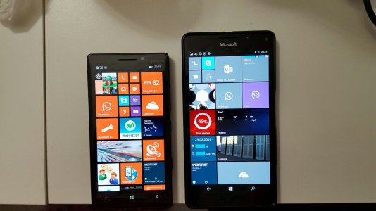

950XL wifi problems, keeps dropping connection to 5.0GHz network
Nevil Alekov
Feb 23, 2016
11
Visit site
950XL wifi problems, keeps dropping connection to 5.0GHz network,I have other nokia 930 work perfect with the same router.where is the problem with 950xl_
