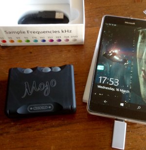

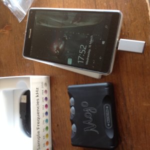

I received the Mojo today. Unfortunately I can't test it because
A. Mojo requires 10 hour charge before 1st use (according to setup instruction)
B. Dummy me forgot to order a male USB OTG cable for the USB-C adapter (seen attached to WP)
Love the size of the Mojo. Can't wait to hear it one day!

I got around to trying my new Mojo with my Lumia 950XL. Apparently it does not work which I discovered for myself when trying the connections and then doing a google search which eventually led me over to head-fi.org.
I purchased a VicTsing USB-C adapter (see previous post w/ photo) and tried both the Mojo-included short USB-A/Micro cable and another longer Monoprice USB-A/Micro cable. Both connections yielded a "This USB device may not work correctly" error message on the WP as soon as the Mojo powered on. First I thought it might be the cable/adapter itself so I connected the 950XL with same cables to an AudioEngine D1 and it worked, playing FLAC music from Groove music app. I then tried connecting same cables back to Mojo but this time connected to my Windows 7 (work) PC. Windows auto-downloaded a driver but I went to Chord's website to get the specific Win7 driver per their instruction on box anyway. After drivers installed the Mojo worked, playing stuff from iTunes. So it's a WP-related issue.
I am wondering since Chord have a driver for Windows 7 OS do they need to provide something for Win10 Mobile?
I received an email response from Chord's Marketing Manager:
"I'm sorry to say that we have discovered that Windows phones do not work with Mojo as they are unable to install the drivers needed. Other Windows tablets are able to, along with Windows PCs."
Oh well. :unhappy:
