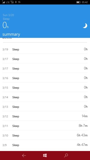

There was a Band 2 Update last week sometime I think and after I installed it I no longer can track my sleep.
I do have a Lumia 950 XL Fast Ring, and changed my language to Norwegian in order to get the band to sync-- however even before I got the 950 XL's update which broke the API, I noticed a few mornings waking up to 0s asleep, despite normal hours in bed.
Trust me, I was asleep!
Anyone have any idea what is going on? I don't feel like losing the gathered data, but if my only option is to try factory resetting, I guess that's what I have to do.
Thanks in advance to anyone who takes a moment to reply :)

I tried an automatic detection as well, forgot to mention-- didn't work, that's the gap in dates in my original SS. Detection used to work just fine.
All the 0's are manually set, the duration of sleep and heart rate are recorded and work fine. It's the sleep that is not registering.
Now that I see I'm not alone, how do we get this feedback to the right places?
Soft reset didn't work, repaired it, too. I guess I have to try a factory reset. I'll post again tomorrow.
