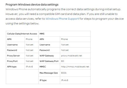

mms settings from att support attached below.... but there's more parameters on the device... what did you end up with, that's confirmed to be working on your device. (would like to use same on mine)
Hey ixhussa, not sure if you were able to get MMS working, but wanted to confirm that the settings you listed from the AT&T site work for me (950 DS, US variant). In the MMS APN settings, the only different parameter names are the following (AT&T/W10M):
WAP Gateway = Proxy Server
WAP Gateway Port = Proxy port
Two things to make sure that you're not doing. 1. When it says, 'Not Set', in the AT&T chart, those fields should be left blank in the MMS APN settings. 2. Don't put 'k' in the Max Message Size, just input it as '600' in the MMS APN settings.
The rest of the parameters in the MMS APN, that aren't listed in AT&T chart, can be left blank. I hope this helps. Good luck!
